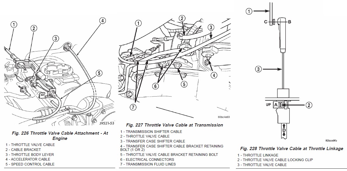

Här är instruktionerna till vajern, för att kontrollera så den är rätt inställd (kan lägga upp justering också om det behövs):
[bilder]http://www.usabilforum.se/forumuppladdn ... lvajer.jpg[/bilder]ADJUSTMENTS - TRANSMISSION THROTTLE VALVE CABLE
A correctly adjusted throttle valve cable will cause
the throttle lever on the transmission to move simultaneously
with the throttle body lever from the idle
position. Proper adjustment will allow simultaneous
movement without causing the transmission throttle
lever to either move ahead of, or lag behind the lever
on the throttle body.
ADJUSTMENT VERIFICATION (kontrollera innan justering påbörjas)
(1) Turn ignition key to OFF position.
(2) Remove air cleaner.
(3) Verify that lever on throttle body is at curb idle position (Fig. 226). Then verify that the transmission throttle lever (Fig. 227) is also at idle (fully forward) position.
(4) Slide cable off attachment stud on throttle body lever.
(5) Compare position of cable end to attachment stud on throttle body lever:
* Cable end and attachment stud should be aligned (or centered on one another) to within 1 mm (0.039 in.) in either direction (Fig. 228).
* If cable end and attachment stud are misaligned (off center), cable will have to be adjusted as described in Throttle Valve Cable Adjustment procedure.
(6) Reconnect cable end to attachment stud. Then with aid of a helper, observe movement of transmission throttle lever and lever on throttle body.
* If both levers move simultaneously from idle to half-throttle and back to idle position, adjustment is correct.
* If transmission throttle lever moves ahead of, or lags behind throttle body lever, cable adjustment will be necessary. Or, if throttle body lever prevents transmission lever from returning to closed position, cable adjustment will be necessary.

har justerat ned tomgången lite idag och passade samtidigt på att flytta vajern från lådan(den på bilden)fullt åt båda hållet och även hänga av den utan nån skillnad(lite skillnad kanske men inte nån wow-skillnad). Märker även att den ibland vill starta på 2an istället för 1an osv när man står och ska iväg ifrån korsningar osv...
